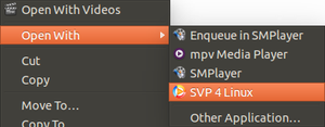

Just add –input-ipc-server=/tmp/mpvsocket to mpv args (or config file) and SVP should find it. Alternatively you can “open” video file via SVPManager — it’ll execute mpv with the correct argument.
