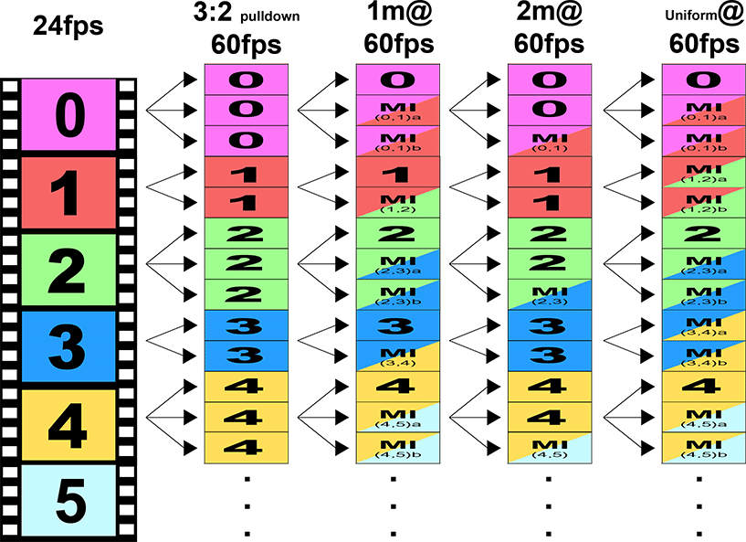

from wiki: SVP:Profile - Frames_interpolation_mode:
2m (every original frame twice) - the largest number of repeats the original frame, minimal smoothness
from wiki-2: SVP:Technical_insights - x-m_modes:
The 1m mode saves all source frames, but on playback one of the frames is being displayed with a small delay. This is why the video quality enhances and the motion becomes less uniform. Also if the GPU boost is disabled the CPU load decreases.
So, for conversion 24->60 the following frame sequence will be built:
<frame 1> - <frame 1 + 33%> - <frame 1 + 66%> - <frame 2> - <frame 2 + 50%> - <frame 3> - ...
2m mode is similar, but every source frame is being shown twice:
<frame 1> - <frame 1> - <frame 1 + 50%> - <frame 2> - <frame 2> - <frame 3> - ...
Also you can see post of vanden. Picture from there:
http://www.svp-team.com/forum/misc.php?item=3477
And yes. You are right. 2m mode with 24 fps video on 48 Hz display will give you no one interpolated frames. Just every source frame shown twice.
60fps.png, 45.51 kb, 817 x 593
Re: "2m" algorithm with 24fps video on a 48hz display
Thank you Mag smile
Very nice chart explaining the difference.  May I ask then what the difference between 1m and Uniform is if the "target frame rate" is set to only 2x?
Also to clarify, does "Standard" switch between 'Uniform' and '1m' and such as it deems necessary?
Nintendo Maniac 64
No difference. 1m and Uniform shosw different picture when smooth factor is not integer.
Sorry. What you mean?
6 (edited by Nintendo Maniac 64 24-05-2015 17:13:35)
Oh, well, that explains why I've never seen a difference with "Uniform" - I always interpolate by exact integers! (since my monitor can handle a wide range of custom refresh rates)
Sorry, I meant "Adaptive". ('Standard' is an 'SVP shader' setting >_>; oops) If 1m and Uniform are the same for non-fractional framerate interpolation ratios, then how does "Adaptive" compare to 1m and Uniform?  Does it also only do something for fractional ratios?
7 (edited by Fanty1972 27-05-2015 21:58:20)
Well, Adaptive dynamically switches between Uniform, 1m and 2m (dont know if it actually includes 1,5m) during the movie, based on the estaminated quality of the motion pathes. Its not a mode by itself. My guess is, it doesnt care if 1m looks identical to uniform, it just choses 1m if the quality drops below the treshhold.
