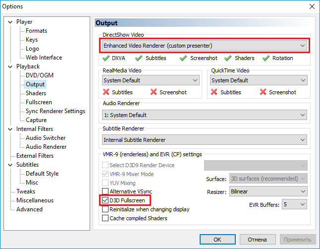

Check if you are using madVR. You have monitor with high resolution:
2560x1440 @164.769
It can lead to high GPU load while render 1080p video in fullscreen mode because of upscaling.
Try to reduce madVR settings or select another renderer. For example EVR Custom with D3D Fulscreen option enabled.
Re: Audio cutting out whilst using SVP
I'm not using madVR unfortunately, just checked and my settings are like that screenshot and the issue still persists.
