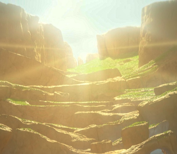

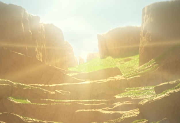

I'm fairly new to SVP.  I'm using the AVI Synth Filter with the latest Madvr.  I've noticed some banding appear in scenes that don't show banding when "Temporarily disable SVP" is enabled.  I've included some screen snips that will hopefully demonstrate it.  Look at the sky.  Any ideas?
svp-disabled.jpg, 48.05 kb, 626 x 431
svp-enabled.jpg, 68.89 kb, 611 x 529

10-bit encoding? if yes, then check SVP -> App. settings -> Add. options -> Allow output in 10-bit color depth
note that 10-bit output doesn't work with EVR renderer

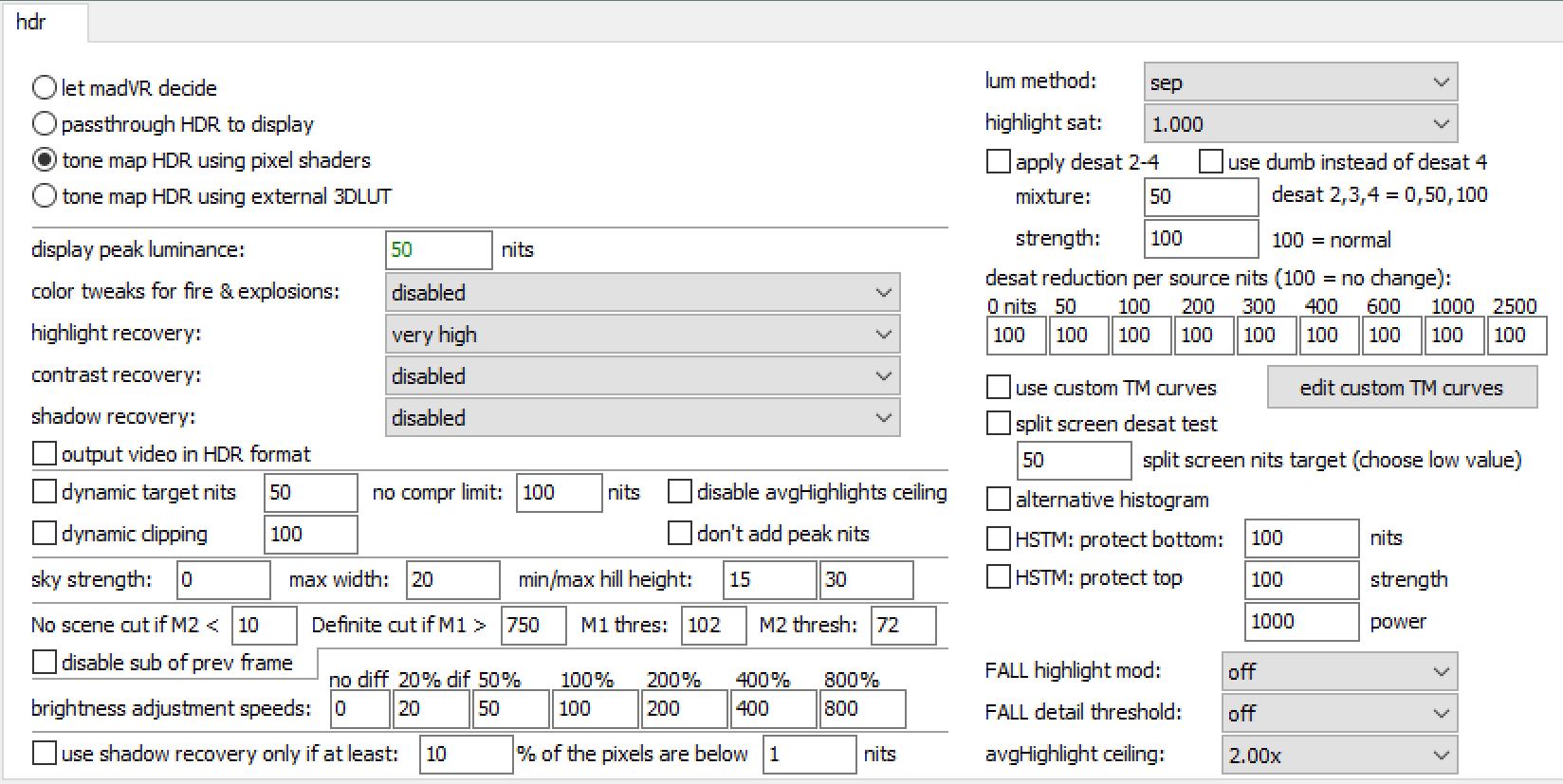

So, I did a little more research and found that the banding was linked to enabling MadVR's HDR "Highlight Recovery" feature.  If I have SVP enabled and Highlight Recovery disabled then the banding goes away.  If I disable SVP and enable Highlight Recovery then the banding goes away.  If both are enabled then the banding appears.
Given the link to a specific MadVR setting, I'd understand if you didn't find it worth your while to research further.  But here are steps to reproduce it if you are interested:
* I'm using this version of MadVR: https://www.avsforum.com/threads/improv … t-60520084
* I'm using MPC-HC with AVSF
* I've attached an image of my MadVR settings that duplicate the issue.
* I've PMed you a link to the video clip.  Though I expect just about any HDR source will duplicate the issue with Highlight Recovery enabled.
Thanks!  Let me know if I can help in any other way.
