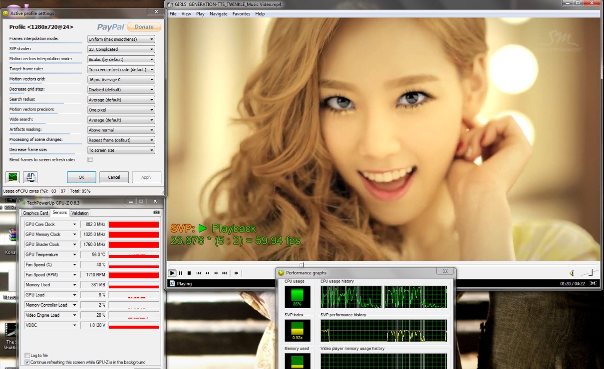

When playing 720P videos using MPC that came with SVP 3.1.2, I can almost reach the perfect settings without maxing my CPU. (See attachment for my settings).
However, after using GPU-Z to inspect the GPU load of my video card, I realized that it is only working at 25% capacity while my CPU is maxed out at 100%.
I tried the advice here (http://www.svp-team.com/forum/viewtopic.php?id=516) and used the LAV decoder with the NVIDIA Cuvid hardware decoder, but I didn't see any difference in the CPU/GPU consumption and the video output.
Oh yeah, GPU Acceleration (OPEN-CL) is ticked in the manager.
So, my question is, would it be possible to off-load some of the processing to my video card because, as we can see, it can still take on more processing? This is in hope of maxing the setting for 720p, and be able to play 1080p videos using SVP.

Thanks for the reply!
Yep, I'm using LAV decoder as laid-out in the tutorial link you've provided. Even so, my GPU is only running at 25-30% while my CPU is running at 95-100%? Is it possible to offload more computation to the GPU?
Re: Force GPU to perform interpolation?
nope
may be this'll change in the future
