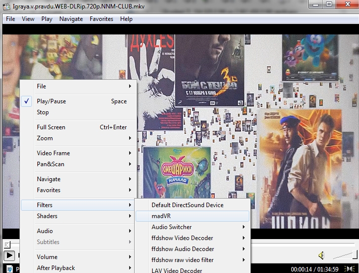

I use MadVR render
show me the same picture from your MPC during playing
http://www.svp-team.com/forum/misc.php?item=2907
ewrwerwer.jpg, 278.91 kb, 720 x 547
