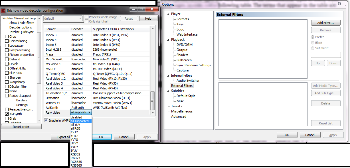

Is there something wrong with my installation? Everytime I want to play a video with "Smooth motion" support I have to reconfigure the "ffdshow raw video" filter after the playback started.
In the "ffdshow raw filter" properties window there is a "Show/hide filters" section (Reachable in MPC-HC through: <right click>->Filters->
ffdshow raw video filter>Properties...). In this section you can find two lists. One empty list called "Available filters" and another list called "Visible filters". I have to
put the "AViSynth" filter from the "Visible filters"-list to the "Available filters"-list. Otherwise I get very laggy output - It looks like smooth motion - with that
"SVP ...slow performance (SVP index: 0.63 - 0.80)" message on the OSD. There is no such problem with the "AviSynth" filter in the "Available filters" list. I get smooth playback
with a SVP index of around 1.0*.
I also configured the "ffdhsow raw video filter" in MPC-HC while no video file is beeing played (Under Options->External Filters->ffdshow raw video filter). The "AviSynth" and
another filter I choosed appear on the "Available filters" list - even if MPV-HC is restarted. If SVP is beeing initialized it looks like the list gets overwritten and SVP runs with very bad performance.

I changed my configuration to reflect the behaviour you just introduced to me. I also had to adjust the "AviSynth" Format in that configuration window. It was set to disabled.
