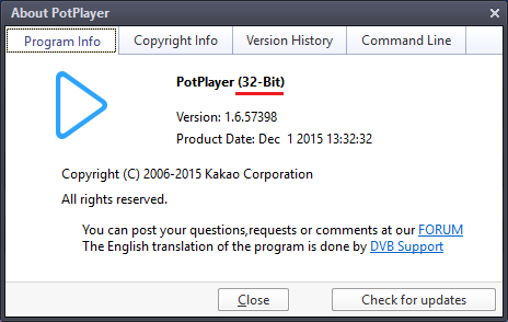

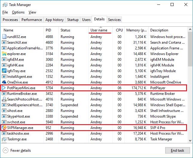

PhysoTronic
1. You must use 32-Bit version of PotPlayer: PotPlayer menu - About.
2. Both processes (SVPManager and PotPlayer) must be run from the same user. Check it in the Detail tab of Task Manager.
PotPlayer_32-Bit.png, 12 kb, 464 x 294
The_Same_User_name.png, 44.98 kb, 646 x 528
