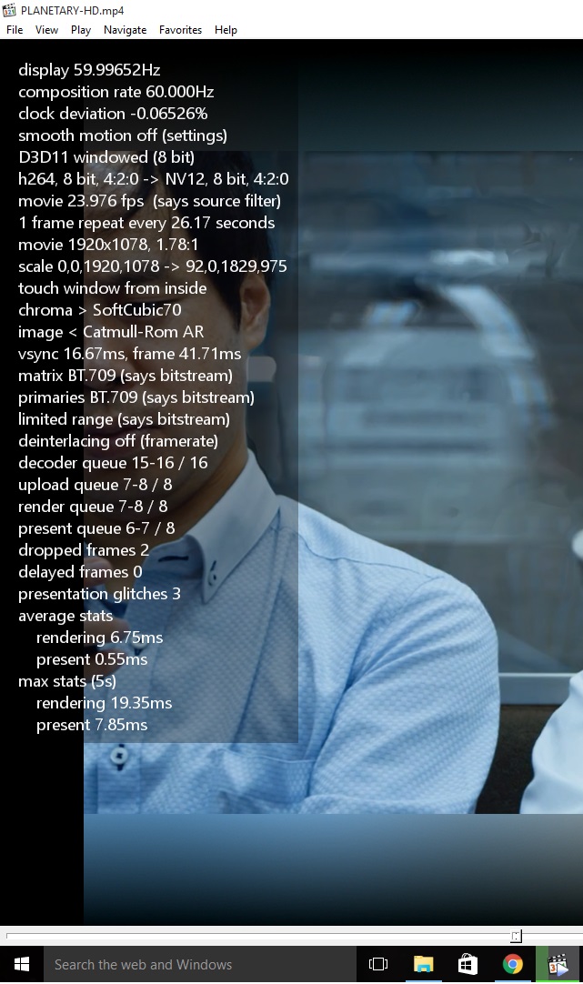

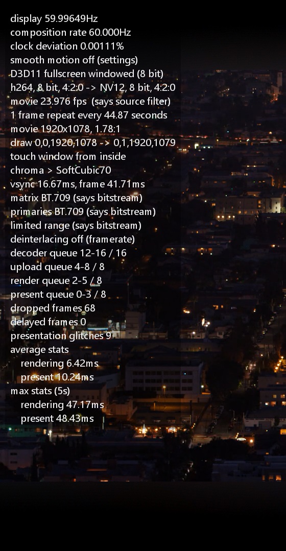

Issue summary(all videos):
Full screen playback lagged once per second. (Tearing test orange line 'twitching' often)(Exclude overlay-ed full screen and windowed)
Render queue drops, present queue drops to 0.
0-1 drop frames per second, sometimes with color tile artifacts(In the video not shown)
CPU, GPU usage under normal range.
(see https://youtu.be/WlQo4b96Qbw[Uploaded, note that follow the mouse movement are important])
(see log and images)
