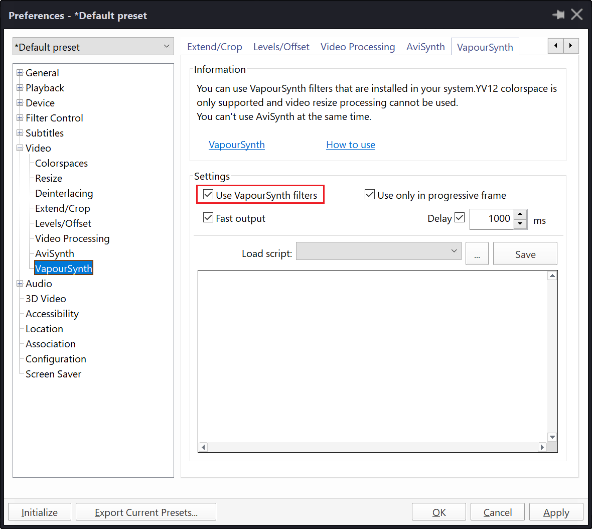

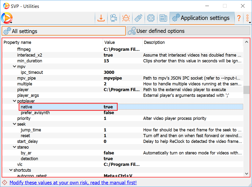

Re: MPC crashes at start of playback, script access violation error
As it looks like Avisynth error You can try to use VapourSynt.
1. Install PotPlayer (64bit version).
2. In PotPlayer enable VapourSynth: Preferences - Video - Vapoursynth - enable Use VapourSynth filters option.
3. In SVP enable PotPlayer's native VapourSynth engine - Application sttings - Additional options - enable option main.setup.potplayer.native = true
https://www.svp-team.com/forum/misc.php?action=pun_attachment&item=4592
https://www.svp-team.com/forum/misc.php?action=pun_attachment&item=4593
