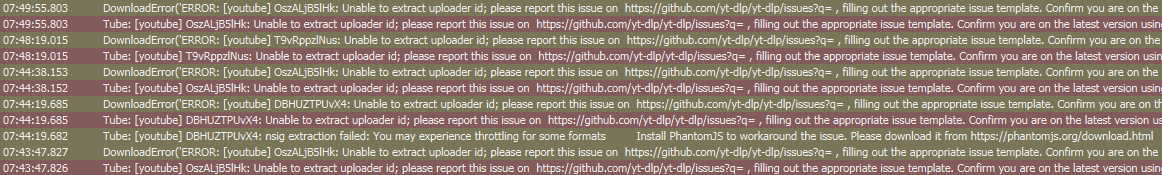

Yes, I've reported an issue with youtube-dl about twenty hours ago.
And also I'm sure that I wasn't the only one. It's been mentioned in the Russian subforum as well.
They are probably aware of the problem and currently working on the solution.
Just wanted to answer your question so you didn't feel like being left in a vacuum ;)
this's very kind, but this question is regarding Crunchroll, not Youtube wink
